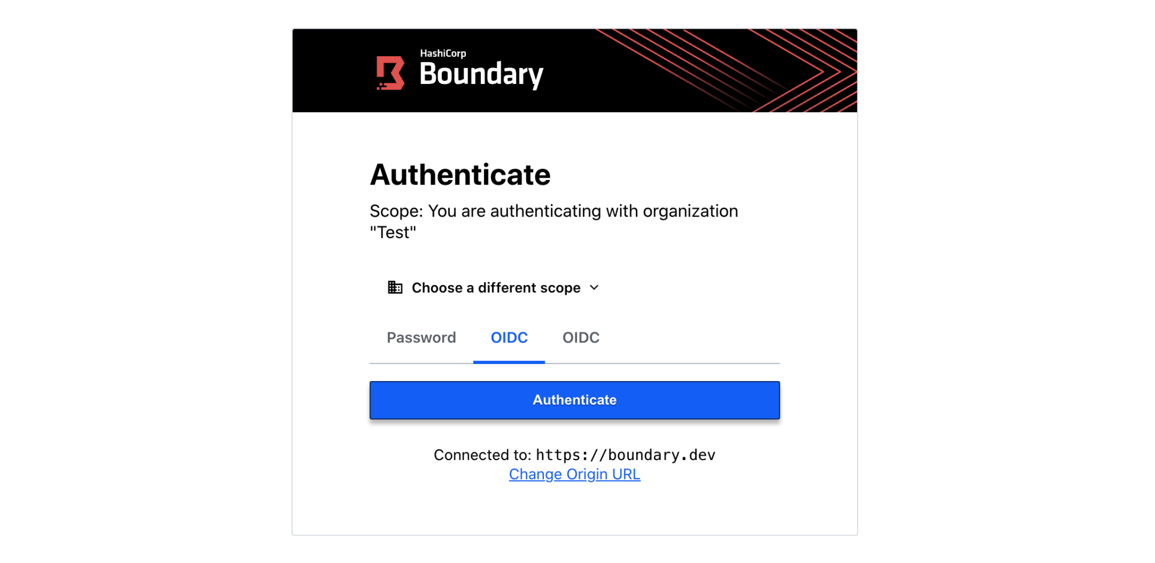

»OIDC Authentication Method
One of the community’s biggest asks since Boundary’s launch is the ability for users to leverage external identity providers (IDPs) to log into Boundary. Boundary 0.2 adds support for OIDC authentication methods, which allow users to delegate authentication to an OIDC provider. This feature enables Boundary to integrate with popular identity providers like Microsoft Azure Active Directory, Okta, cloud identity management systems such as AWS IAM, and others.
Boundary
In this release, users can create, read, update, and delete a new OIDC authentication method resource and then use it to login via the CLI, Boundary Desktop, or the Boundary Admin Console. OIDC auth method configuration is initially available via the command line, and in upcoming releases we’ll also be integrating OIDC configuration into Boundary’s Terraform Provider as well as the Boundary administration console..
To get started with creating OIDC auth methods to log into Boundary with common OIDC providers, check out the new Boundary OIDC learn tutorial.

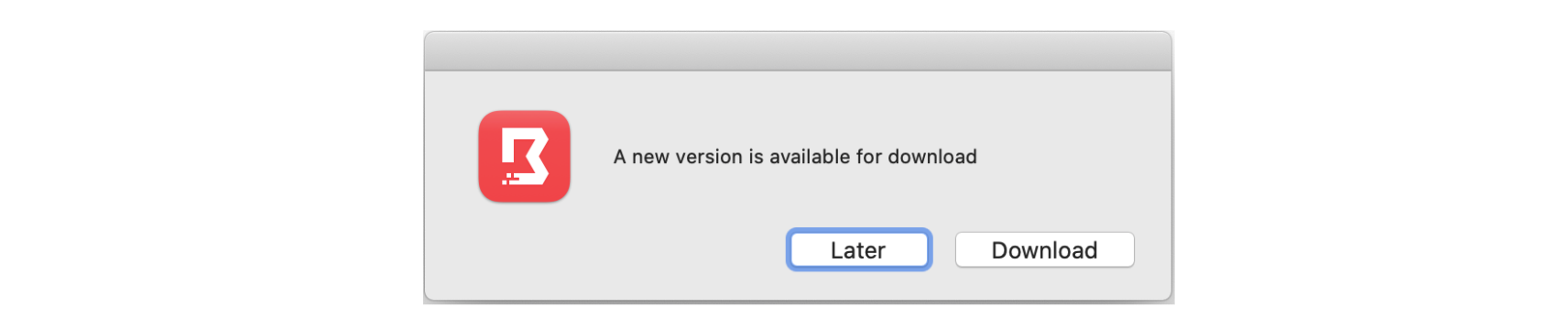

  • AutoUpdate for MacOS: AutoUpdate the Boundary Desktop app as new versions become available.
